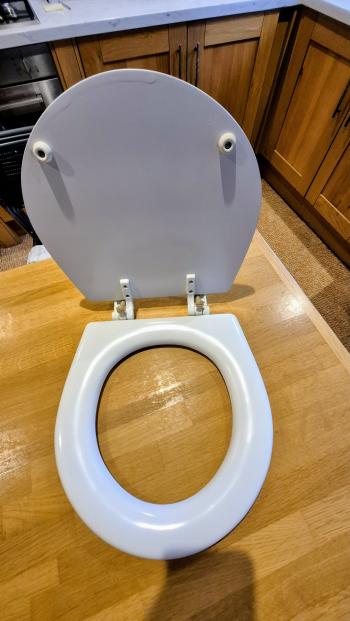

Bemis seat over 15 years old now looks like new.

My Bemis toilet seat was in a pretty poor state. Cost to replace was expensive for a compact seat and hard to find supplier with it in stock.
Plan B was to sand down all the badly chipped corner edges, with light sand 600 grit over the main surfaces.
I decided to use Jenolite enamel bath repair spray. Four light coats seemed to do the trick at only £11.99. If it was boat spray, no doubt it would not be cheap!
